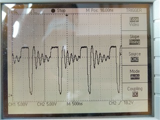

2. BQ25792 alternating between PFM and PWM mode
- To investigate point 1, we check the SW signal with an oscilloscope. The measured waveform as shown below seems to suggest that the BQ25792 just keep alternating between PFM mode and PWM mode.
3. Severe Ringing at SW output
- Upon further checking on the PWM waveform, we also find severe ringing in the PWM output. Some of my colleagues with good ears can also hear high frequency noise from the board.

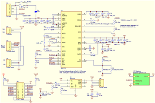

Below is the schematic of the board :
Hope someone may share your experience with us.

  • Stony,
    I noticed that /CE pin is pulled high.  This disables charge current into the battery.  Is the schematic correct?

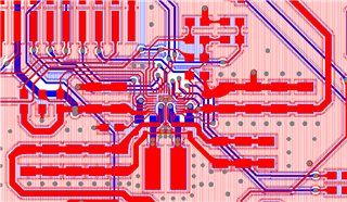

    Would the ringing problem be related to the choice of the components or the PCB layout ? Below is our PCB layout. The board is a 4 layer board and there are two internal ground plate not shown in the below image.
    Normally we will simply do more trial and test with different components or even PCB layout. However, as there are currently global shortage on this IC (my search reveals that the earlier parts availability is in 2022) and so we really want to plan carefully before we modify the board so as to avoid any damage on the IC.
    As for the query concerning the /CE pin connection that you raised in another post, that design is intentional as we want to change the charging current to 0.3A before enabling the battery charging. We have double checked that this /CE pin has been pulled low by the MCU during the test.

  • Hi Stony,
    Thanks.  I will review the registers in more detail and get back to you.  Regarding the ringing, a converter operating in discontinuous mode has ringing similar to your second plot above.  I would expect the pulse to get closer to ground than what your plot shows, however.  Can you check the BTST nodes and make sure they look like the SW nodes but ~5V higher voltage?

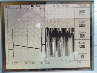

  • Hi Jeff,
    Really appreciate your effort in studying the registers.
    And below are the waveform at SW1 and BTST1.
    The BTST1 waveform does appear to be a few volts higher than the SW1 waveform. And also revealed from the above photo, it seems that there were missing pulses in the switching output.

  • Hi Stony,
    I assume you were bucking with VBUS>VBAT at the time?  If so, then there is problem with either the IC or with BTST1 capacitor and connection to BTST1 in and SW1.

  • Hi Stony,
    I don't see any obvious issue on the PCB.  Can you remove the IC and place on a BQ25792EVM?
