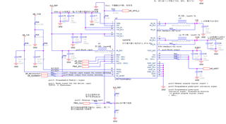

Hi There,
I have a failure device, The device has been working for around 3 months. After some output voltage measurement, I found the failure is caused due to 1.8V is not generated properly. only 0.747V is observed on this rail. I checked the input voltage is still correct: 3.3V. and 1.24V output is also correct. And 5V output is also correct.
I tried to disconnect the load from V1.8 rail, the voltage increased a little bit to 0.9V... still abnormal. I tried to re-solder L2 (see below schematic for reference), I found unpredictable voltage could be seen on 1.8V rail: 0V, 0.7V, 1.8V could be seen randomly (means sometimes I resoldered L2, I found the voltage is 0V, then I resolder L2, the voltage change to 0.7V or 1.8V...). I believe the soldering is properly each time. So I do not think it is related to L2.
Any hints what might cause this failure?
Note: no I2C config done after power up. everything keep default state.
Here is the schematic for your reference
Thanks and Best Regards
