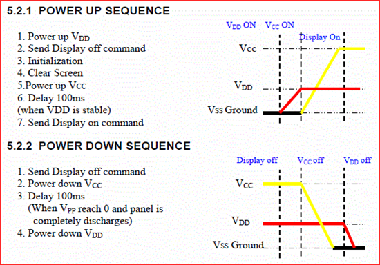

Hello All,
I am trying to supply an OLED display (Densitron DD12864YO-7A) requiring just under 100mA@12V (at 100% display), from a 3.3V source (with enough supply current).  I was looking (due to simplicity) at TPS61040, but all examples and calculations (from the datasheet to the EVM) are way below the display max. required current.
Is the TPS61040 capable of doing that?
