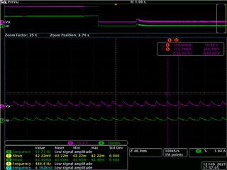

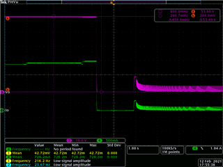

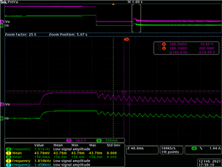

When TPS2372 is configured for Type 4 PoE and I pull more than 70W with a 300+ foot Ethernet cable (or 90W with a 1-foot cable, equivalent to 70W with a 300ft cable), instead of the TPS2372 protecting itself and opening up the internal MOSFET to stop current consumptions, it seems the TPS2372 is trying to regulate the PoE output voltage/current even beyond these power consumptions (see oscilloscope screenshots below).  During a PoE over-current event, the TPS2372 gets very hot (~130C) very quickly.  Instead of the TPS2372 completely shutting down the current flow, the PoE output voltage and current oscillates at 50Hz~100Hz causing the rapid 130C self-heating.  I did not leave it in this state long enough to damage the TPS3272 part, but I assume it would eventual be damaged if I did leave.
By the way, the same thing happens if the TPS2372 is configured for Type 1 PoE, and I try to draw 30W.  Same over-current event happens, and the voltage and current oscillations occur resulting in the same self-heating up to 130C.  Please help!
My setup includes a PoE injector connected to the TPS2372-4EVM-006 Eval board (also tried with my own board with same results), and a resistor load box connected to the VDD/RTN output power lines.  I tried to pull up to and beyond 90W.  I was anticipating that the TPS2372 would protect itself and shut off the power if tried to pull to much power, but it instead the voltage and current

  • Hello Nick,
    I was able to reproduce this in the lab. What is happening is during the overcurrent, the IC reverts into the in-rush phase after the overcurrent phase is done. The internal hotswap FET opens, so there is a voltage across it. This makes the IC get hot. If it gets out of inrush, there is now a full load current through the internal hotswap, which also contributes to the heat.
    Therefore it is expected that the IC will get hot during an overcurrent event. However, the IC has Over Thermal protection as well, so it should be protected in this situation too.

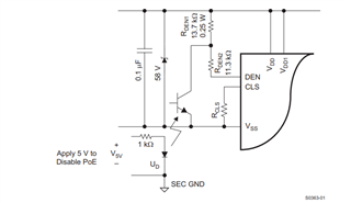

    One strategy you could use is to disable the PSE. Using an optocoupler like below, we can disrupt detection and thus the PSE will shut off power.
