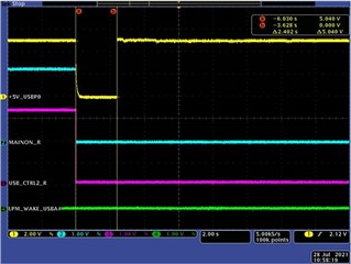

TPS2546 is used on a NB for this project.  When the system has a S0 to S5 power state transition, they'll change the setting of TPS2546 from CDP/S0(CTL1/CTL2/CTL3/ILIM_SEL="1111")  to DCP/S5(CTL1/CTL2/CTL3/ILIM_SEL="0011").
There two different result as summarized below,
  • If the this port is connected to Apple iPhone at this moment, there'll be one stop-charge happening which should correspond to VBUS drop happening once as below.
  • If the this port is connected to Android phone at this moment, there'll be two stop-charge happening which should correspond to VBUS drop happening twice as below.
The channel assignment for these two waveforms as below,
  • CH1:VBUS
  • CH2:CTL1
  • CH3:CTL2
  • CH4:STATUS
Do we know why there's one additional drop for Android phone case?  What can be done for further clarification?

    This is a characteristic of the DCP_Auto functionality and is expected behavior. Hope this helps answer your question
  • HI Adam,
    Thanks for the comments.  May we know why VBUS drop once for iPhone but twice for Android phone?  Do we have related description in datasheet about it?
    Antony
  • Hi Antony,
    Yes here is the relevant paragraph taken from the datasheet (section 8.4.1)
    As mentioned above the TPS2546 integrates an auto-detect state machine that supports all the above DCP charging schemes. It starts in Divider1 scheme, however if a BC1.2 or YD/T 1591-2009 compliant device is attached, the TPS2546 responds by discharging OUT, turning back on the power switch and operating in 1.2 V mode briefly and then moving to BC1.2 DCP mode
    So the first VBUS drop is for transitioning to DCP_Auto and then the second VBUS drop is the TPS2546 transitioning to 1.2V charging mode
