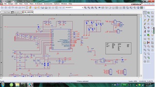

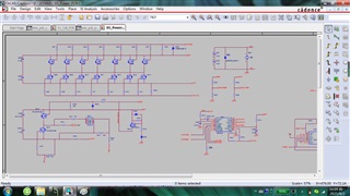

  • My customers said" "Still unable to communicate, the board that can be written to the firmware can not communicate. I'm dying of anxiety. I don't know how to start!
    The schematic diagram is also sent to you to help you see if there is any problem. The pack + in the diagram is the highest end of 7S, equivalent to 7p, and bat + is the output of battery pack"

  • Hi
     I have attached the SCH below
  • Assuming there are pullups on the SMBus lines outside of your schematic, I didn't find anything obviously wrong with your SMBus schematic.
    Can you use a logic analyzer on the SMBus lines and see what it being sent to/from the device? Also can you confirm that the device is not in ROM mode?
