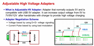

According to the training video "Fast-Charging Trends and Challenges for Single-cell Batteries" I have some questions I'd like to ask,
1.) According to this figure, fi the adapter is 5V, how to let Vbus become higher during operation, I mean 5V, 7V, 9V, 12V.
2.) According to this figure, how do you know when to stop the CHGR2 current, and why the CHGR2 will stop first.
3. What is the deglitch time mean and what problem can it make?
  • Hi Jack,
    Regarding 1, the wall adapter to charger communication protocol shown is a proprietary one used by the adapter manufacturer.  Other protocols, like QC2.0 and QC3.0 use a different protocol with voltage pulses across the USB D+ and D- lines.  USB type C with its CX lines has yet another protocol.  The point is to increase the voltage so that the current reduces for the same power and results in lower V=IR losses across the adapter cable.
    Regarding 2, in the parallel configuration, one charger's regulation voltage is set slightly lower than the other so that one charger exits constant charging (CC) regulation and enters constant voltage (CV) regulation before the other.  Otherwise, with two voltage regulating sources trying to regulate the same node, there could be unstable oscillations.
    Regarding 3, deglitch time refers to a delay before a comparator that is comparing  a current or voltage to a reference voltage/current makes its decision.  It is intended to prevent a decision based on a transient/noise spike and allow the monitored current or voltage to settle to a steady state.  I refer to it as "time hysteresis".
