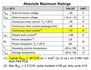

CSD25402Q3A: Help to simulate the continue current at worst thermal condition
Part Number: CSD25402Q3A
Other Parts Discussed in Thread: BQ25713
Hi Team,
We mentioned that the absolute value of the max continue drain current is 15A at 45C Rja.
Can you help to simulate or calculate if the thermal condition is 70C Rja, then the maximum continue drain current  will be how much ?
Thank you!
Kai
