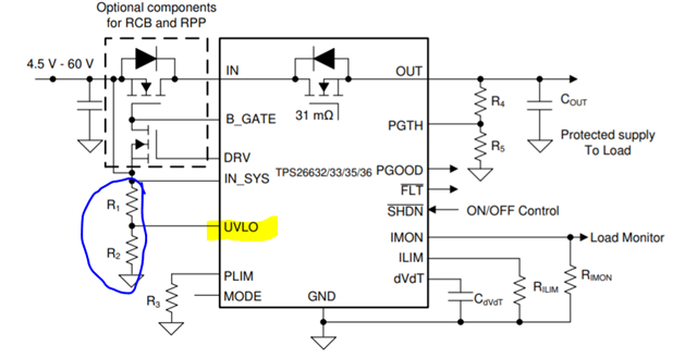

Hello
It looks like both the datasheet and the design calculator for the TPS2663X assumes an OVP pin.
But devices without the OVP pin (with a PLIM pin instead) will not use three resistors in the string.
How do I calculate the UVLO for devices without an OVP pin?
Lars
  • Hi Lars,
    Thanks for reaching out!
    Assuming now you have only R1 & R1 ladder at UVLO pin.
    V(UVLOR) = 1.2V = V(UV) * R2 / (R1+R2)
    where V(UV) is the target VIN UVLO threshold.
    Now you choose R1 as 470kOhm and calculate R2
