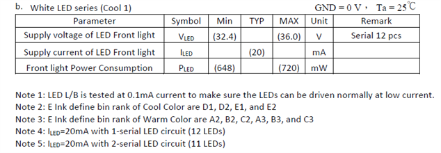

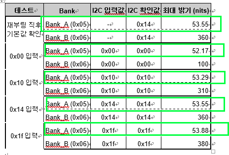

    I have a question during the test.
    I am testing by applying exponential MAPPING MODE.
    Measurement was performed by changing the value of the Full Scale LED Current register.
    However, as shown below, the max brightness in LED_Bank A is not working properly, so I would like to ask.
    LED_Bank A (COOL LED) Number of SERIAL LEDs: 12
    LED_Bank B (WARM LED) Number of SERIAL LEDs: 11
    What causes LED_Bank A not to work properly?
    If there is anything that needs confirmation, please reply.
    As a reference, the spec of the LED under test is added.
    Thanks.
