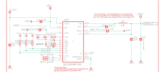

On a custom board, I'd like to get about 1.5A charge current out of this BQ25895MRTWR.  However, I'm only getting around 500mA.  Below is a snapshot of the registers along with my comments.
It appears that the chip is getting into DPM mode due to IINDPM.  However, I have a fixed 5V supply feeding the chip (not USB), whose value is confirmed by Reg11 (and measured at chip pins as 4.987V).  This should be well above the FORCE_VINDPM absolute VINDPM threshold of 3.9V.  Meanwhile, IINLIM and IDPM_LIN are both set at 1.5A.  So why am I only getting 600mA.
Note as well that the incoming 5V supply feeds both this charger and another load of about 800mA.  But the 5V is not falling below 3.9V.  It's holding well.  Nevertheless, when I decrease the 800mA load, the charge current rises to about 750mA.  This makes no sense.  First, it's still not 1.5A.  Second, the incoming 5V on VBUS looks good at 5V, never 3.9V.  (On the scope, that power looks good, with the worst glitch being a ring down as low as 4.6V lasting about 300ns for 3 dips in the ringing.  This still remains well above 3.9V and is very fast.)
I note also that VBUS_STAT is 0b111 for OTG.  Perhaps the chip figures OTG because of the 5V incoming supply.  Datasheet Table 3 mentions IINLIMs per VBUS_STAT, but 111 (OTG) isn't listed.  I have D+/D- detection disabled anyway.
Here are my notes.  Hopefully you can click on them to enlarge and make legible.  The small size I see below was the default for drag and drop into the forum.  I attached a pdf version of the same, just in case...
Battery Charger Status 20210801.pdf
  • Here's the local circuit:

  • Hello Helmut,
    The charger is limiting the input current limit, from what it seems you have a load and you are charging the battery. This means if you set the INNDPM to 1.5A and 5V input, you have 7.5W total power that can go to the load or battery (assuming 100% efficiency). INLIM in REG00 is not the charge current, it is the total input current.

  • Wyatt,  Thanks for the quick answer.  Sorry for my slow followup, as the email notification about your reply went into my spam folder.
    So, following up.  I understand your 7.5W total power mention.  That load is roughly 860mA @ 4.3V, call it 3.7W.  This would leave about 3.8W for battery charging.  At roughly 4.3V this leaves about 804mA.  This seems reasonably consistent with the facts.  This suggests I need to increase IINLIM.  Oh, ignoring Watts and just counting amps, 1.5A - 860mA => 640mA for charging.  Even more consistent.
    I tried IINLIM=2.5A (REG00 == 0x30, HiZ disabled, ILIM pin disabled).  No increase.  I tried IINLIM=3.25A.  Still no increase.

  • Here's an update, Wyatt.  Having fully discharged the battery overnight, and having set IINLIM=3.25A, I now see much higher battery charge current, as desired.  My 12V bench supply began at 1.80A into the overall system, while in the past it never exceeded 1.36A.  That extra 0.44A at 12V must have been very high current into the battery.  By the time I could get into my processor debugger, the 12V bench supply had dropped to about 1.60A.  That's because the battery had already charged up a bit.  At this point, the charger chip regs reported 1100mA.  Much higher than my earlier ~650mA.
    Therefore, indeed, the increase to IINLIM=3.25A was indeed my solution for this very low battery scenario.  I'm now getting in excess of 1A charge current into the battery.  In fact, extrapolating backward to when my bench supply read 1.80A, it's likely I was getting far over 1.5A into the battery for several seconds.
    Meanwhile, I noticed the both my scope on the battery and the chip's ADC for battery voltage were reading roughly 4.3V.  That means the charger chip is limiting itself to ~4.3V, as I hypothesized earlier with REG06 "Charge Voltage Limit'.  Fortunately, because the battery began so fully discharged, that ~4.3V pushing into the battery was able to push over 1A.  That through the battery's internal resistance and to the battery's very low internal charge level.
    So now I'm confident that the charger chip will simply START at pushing ~4.3V into the battery, and the charge current will start well above 1A and then gradually decrease as the battery's internal charge rises, that current amount being limited not by anything in the charger chip or my external system, but instead by the actual internal resistance of the battery.  This means that ALL IS GOOD now for the charger chip and the rest of my system.
