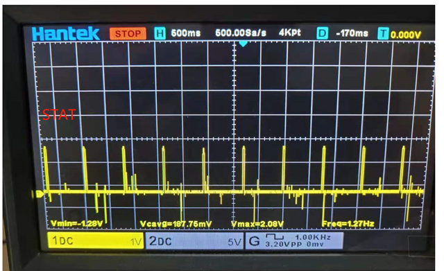

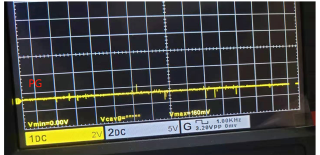

bq24600 does not work normally, STAT pin flashes, PG low.But the flicker frequency is not 0.5HZ,DC power supply current repeats display 0 to set charging current(The charge value set by Viset) jump

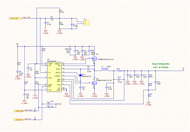

What might be wrong in the design?
    What is your input voltage and supply configured as? How is you battery voltage connected? Can you include a waveform of the input voltage, switch node voltage, battery voltage, and charge current?

  • The current limit of the DC power supply is greater than 2A ,The battery voltage is about 12.3V.When I debugged, the charging current was changed to 0.8A, not the value on the schematic.If the circuit is disturbed, why is it periodic? It’s incredible.
    Please report the designed sense resistor along with the intended charge current. What is the current limit on power supply?

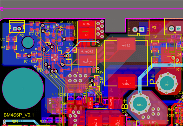

  • Thanks  Michael,
    I found the cause of the problem,The pins (STAT  & TS)on the bottom of the component are short-circuited during soldering and cannot be seen from the outside.
