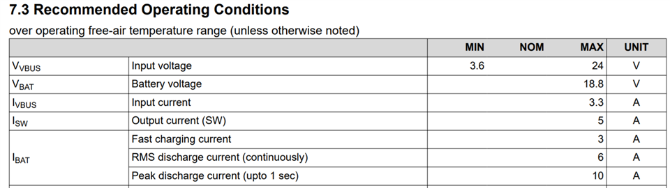

As datasheet, I cannot find internal MOSFET spec. about related current information.
May I know if BQ25672 can support 2.5A input current and 4A output current or not?
Thanks.

The input power is 12V*2.5A(30W) and the output is 3.7~4.2V*4(~17W Max.).
Thanks.
HI Peter,
The device can easily provide the output power you need from your input source. Keep in mind, the charge current is limited to 3A but total output current (ISYS+IBAT) is 5A.
