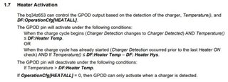

    However, in BQ34Z653 TRM, page 40, chapter 1.10, “Data Flash Configuration”, it reports the following:
    HEATALL (Bit 7): HEATALL enables activation of the GPOD output under ALL conditions.
    So, when HEATALL=1, does the requirement for charger detection remain? Or, at this case, only temperature conditions are checked in order to allow or not activation of heaters? Because only at this latter case, I understand that heaters could be enabled at both charging and discharging modes of operation.
    Otherwise, I understand that only at charging mode of operation, heaters could be enabled since charger detection is required.

  • Hi Vincenzo,
    I apologize for the confusion, after re-reading through our documentation I do not think it turns on during discharge. However, the DSG FET does not get turned off so discharging could occur after the heater has already been enabled since GPOD is deactivated when the temperature > DF:Heater Temp.
    Based on the snippet below, my understanding is that the charger still has to have been detected at some point. The difference is whether the heater turns on only at the time the charger is detected vs the charger is already detected and there was a sudden drop in temperature.
    Let me know if that makes more sense.
