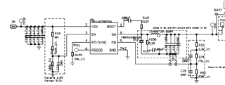

Hi Team,
Customer report there is some abnormal switching frequency issue when using LMR16020.
They set the output 9.11V, and the load is the constant resistance mode of the electronic load, switching frequency is 620kHz.
When the input voltage is drop down to 10.4V, the switching frequency will change to 103kHz, and the output voltage will change to 8.95V.
The question is why will the switching frequency change when the input voltage drop down? What's the operation mode of LMR16020 at this time?
Thanks.
  • Hello William,
    The converter is likely operating in dropout where the difference between input and output voltage is small. (See figures 7 and 8 in the Datasheet)
    The frequency must reduce in order to ensure that the BOOT capacitor can recharge in order to turn on the high side FET.
    Let me know if you have additional questions.

  • Hi William,
    The switching frequency will return to normal when the input voltage is increased.
    The minimum requirement between input and output voltage is given in the maximum duty cycle spec in section 6.6 (97% at 200kHz fsw), this gives the minimum off time (toff) of 150ns.
    Use the following equation to estimate the minimum input voltage:
    toff = (1-D)*Tsw
    where D=Vo/(Vin*efficiency)
    Tsw = period of desired switching cycle
    toff=150ns
    efficiency = ~90% (estimation)
    I calculate minimum Vin of around 11.1V.
    Try increasing the input voltage and let me know whether the output voltage come back within regulation.
