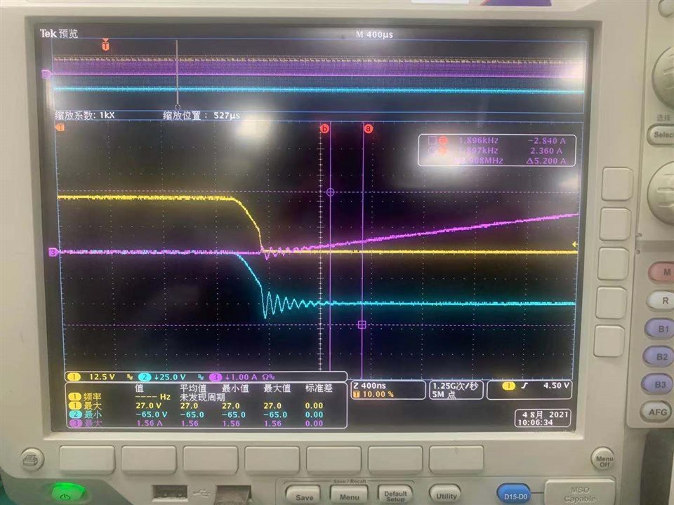

My customer is evaluating LM25184-Q1 in their new gen platform. Could you please kindly help comment how to improve below oscillations?
1. The oscillation of secondary diode turning on (in blue)
2. current overshoot at the beginning of switch conduction period (in purple)
One more question is, what is the SW turning on and off time of LM25184-Q1? Will this influence the oscillation?

    Ringing of the diode voltage is related to resonance of the secondary-referred leakage inductance with the parasitic capacitance of the diode and secondary winding. If this is of concern, please use an RC snubber across the flyback diode.
    The leading-edge switch current spike is related to current charging switch and transformer winding parasitic capacitance as the SW voltage goes to zero (it also includes current to charge the secondary parasitic capcaitances reflected to the primary).
    Both effects are expected for a flyback converter. In general, slower switching may help to reduce ringing amplitude, but this is a tradeoff with efficiency.
    Tim

    Thanks for your reply. One more question from my side is, what's the switching on and off time of internal FET?
    Scarlett
  • Hi Scarlett,
    It depends on the operating conditions, but 10-20ns is a good estimate.
    Tim

    Customer asks for internal MOSFET Coss value, could you please kindly provide this?
    Scarlett
  • Hi Scarlett, use 200pF as an approximation.Note that the transformer and reflected diode capacitance should also be included to derive the effective SW node capacitance.
    Tim
