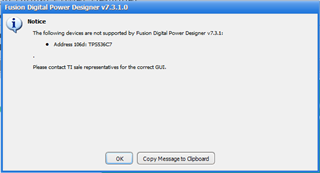

Dears,
Is any way to fix this problem?
BR
Eric
Hi, Eric,
Please download the latest Fusion GUI 7.6.1, released on TI website: https://www.ti.com/tool/FUSION_DIGITAL_POWER_DESIGNER. This version support TPS536C7.
Thanks and regards.
Anne Ngo

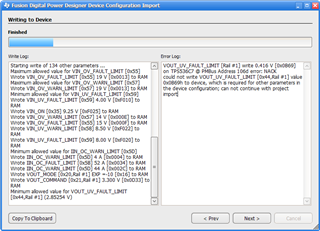

Hi Anne,
Every sample when I update FW will see the error message as below, can you help this?
BR
Eric
Hi, Eric,
Can you attach both project files (xml): project file from sample you try to import the new config to, and project file to try to import to device.
