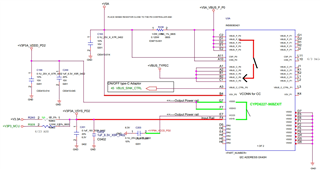

Hello:
1.our project has encountered a problem: tps25947l has no voltage output.
2. Application: + VBUS_ TYPC 100W(20V 5A)。 Practical application in type C adapter voltage conversion
3. The circuit is as follows. The actual measured V+VBUS_TYPEC  and EN have voltage, but Vout (+ VDC) has no voltage output.
Please help us study whether the circuit design is OK and share with us any good suggestions,
Note: VBUS_ SINK_ CTRL is from PD IC (cypd6227).

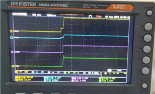

  • Hello Kunal:
    1. Item1 --> 499ohm have changed to 620
    2. Item2  --> waveform as below  , the loading is amost '0' A.
                    Ch1 --VBUS (Input)
                    Ch2 --OVLO
                    Ch3 -- EN.UVLO
                    Ch4 -- VDC(Output)
      Thanks!
  • Hi Jimmy,
    1. One reason I can think is that from waveform OVLO voltage looks close to 1.2v which is the threshold for overvoltage turnoff. Can you check how much is exact voltage on that pin?
    2. Also how much is total output cap at eFuse output?
    3. Can you also probe current in above waveform?
    4. I see output does start to rise but then settles at around 2V. Does it finally goes to zero?
    Kunal Goel
  • Hello Kunal:
    1. Our design circuit is shown in pdf file. The input and output capacitor can directly see the circuit part.
    2. For tps25947, In view of the current problem, can we make further analysis through other experimental methods.
    a. Input
    b. Output
    c. EN/UVLO
    d. OVLO
    e. PGTH
    f. Rimon
    All parameters can be modified and provided through experiments.
    3. Please help study the circuit and IC working principle and share some good suggestions to us. Thank you!
    TPS25947 Design Schematic.pdf
  • Hi Jimmy,
    I did not understand your point 2. Can you explain?
    I have seen schematic . It is fine. Just one comment:
    I see that GND signal is not there at IC GND pin? Can you check this? Is IC GND pin connected to GND signal in layout?
    Kunal Goel
  • Hello Kunal:
    My client knows the grounding problem and have rework, but the result is the same as fail
    At present, we have two projects that will use this material, and the design is exactly the same.

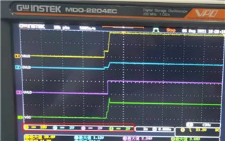

  • Hi Jimmy,
    You shared this waveform and I asked you these question earlier . Please answer these question:
    1. One reason I can think is that from waveform OVLO pin voltage looks close to 1.2v which is the threshold for overvoltage turnoff. Can you check how much is exact voltage on that pin?
    5. Can you check with multimeter voltage on output pin?
  • Hello Kunal:
          --》 Vovlo=2.2V   please view waveform .
    1. Can you also probe current in above waveform?
               --》In advance ,  We can not measure by probe current.  but we can't cut off out loading .
               --》 Result : still fail.
    1. I see output does start to rise but then settles at around 2V. Does it finally goes to zero?
               --> No Zero。
    1. Can you check with multimeter voltage on output pin?
               --> 2.4V
  • Hi Jimmy,
    Voltage on OVLO pin is looking around 1.2V . I think that is disabling part. Can you check exact value of resistor R899 and R900 on board with multimeter?
    Also can we try with low voltage less than 20V say 15V at input and then see what is output?
    Kunal Goel
