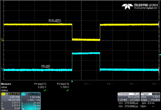

Below is our currently WahctDog "TPS3851H33EDRBR" Circuit and Behavior:
- After ~56.68s no received the WDI single then Reset#/WDO# will go low to the EC25 module(RESET_N).
- Every 30s WDI send signal to reset watchdog timmer,(WDI signal about ~90us)
  so the WDO#/Reset# won't sent low signal to EC25 module(RESET_N).
If we replaced "TPS3851H33EDRBR" with "TPS3852H33DRBT"(Window watchdog timer).
is need to change HW or FW config for the Window watchdog lower /Upper boundary? please advise.
 WDI signal timing
Thanks!

    If the WDI signal continues to output every 30s, I believe you will need to change the CWD capacitor value.  The upper boundary equation is:
    From the schematic, I see that CWD has a capacitor value of 0.68uF.  The upper boundary time is calculated to be:
    tWDU = 52.69 seconds
    tWDL = tWDU * 0.5 = 26.34 seconds.
    The tWDL boundary value is very close to the WDI time of 30 seconds.
    If you change the CWD value to 0.51uF, the tWDU and tWDL values are:
    tWDU = 39.53 seconds
    tWDL = 19.76 seconds
    which makes the WDI time pretty much centered to the watchdog window.
