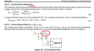

LM25122-Q1: Rs selection
Part Number: LM25122-Q1
Hi team,
What's the minimum value for Rs as below picture shows?
Thanks.
  • hi ,
    You can ref this design tool , calculate the Rs value,  it is can download from below Link.
    www.ti.com.cn/product/cn/LM25122-Q1.
    If allowed, it is hoped that this resistance should be as large as possible, so that more accurate current protection can be obtained.
