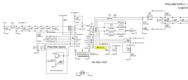

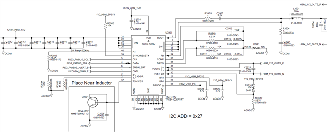

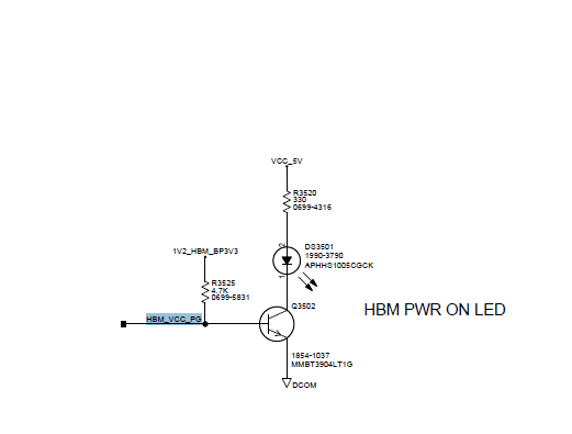

Hi
We have used TPS544C25RVFT dc dc converter in our design but now we are faced issue in PGOOD pin which is output showing low but we are getting proper output voltage so please find below image and help to resolve this things ASAP.
We are not used SMBUS protocol in design so please ignore
Yellow mark pin we are getting low as per output it should be High.
