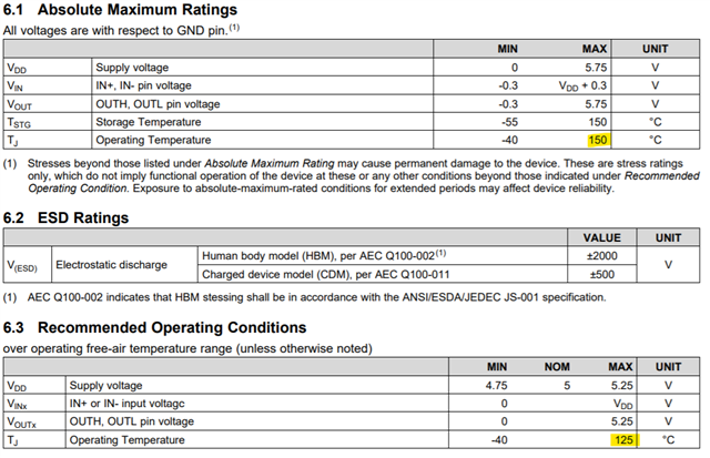

Does the maximum temperature spec refer to junction temperature, ambient temperature, or perhaps something else?
Don
Don
Hi Don,
Thanks for your question. These TJ specs you highlighted refer to the operating junction temperature.
