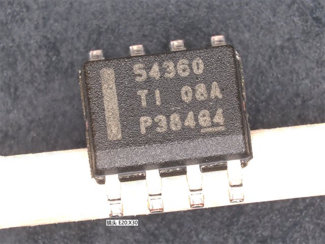

TI/TPS54360DDAR is used on our company’s products(Vin 48V,Vout 5V). From early of May,2021,we found this TI chip Vin(pin 2) to SW(pin 8) short,pin 2 to GND short,pin8 to GND short, and defect rate went higher and higher ,up to 3%,avg.~1% . And we confirmed the failed chips are concentrated on DC2035 and DC2047. Meanwhile we used DC2112 & DC 2101, and no defects were found.

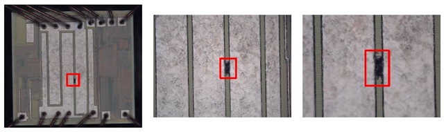

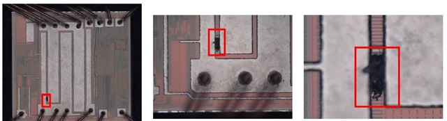

We sent samples of Vin to SW short to 3rd party for physical analysis. Confirmed melt points were observed between Vin & SW traces. What's the problem with DC 2035 and DC 2047 material?
#1 after the de-cap melt point found between Vin & SW traces.
#2 after de-cap melt point found between Vin & SW traces.

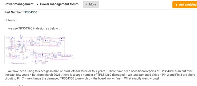

We noticed that from March, there is another customer have same failure symptom for this chip. See as the below picture or via this URL e2e.ti.com/.../tps54360-the-chip-damage.
