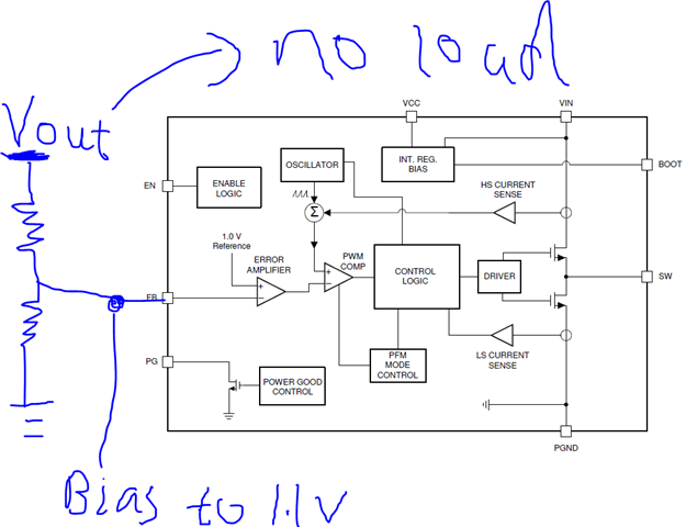

Hi engineers, I'm studying buck circuit through LMR36520 recently, I want to know the power consumption of LMR36520 when no load is connected, so I pay attention to the IQ parameter in datasheet, as show in picture.
Note 2 explain that "This is the current used by the device open loop. It does not represent the total input current of the system when in regulation"
I wonder:
how to test the Operating quiescent current of LMR36520?
what are the test conditions?
what‘s the “non-switching” means?
can IQ-nonSW be used to calculator  the power consumption of LMR36520 when no load is connected?
My understanding about the key test conditions is that :
1.device enabled.
2.FB PIN floating,  the device open loop, so as an actuator in the feedback loop the MOSFET does not switch.
3.Vout floating.
I‘m looking forward for your answer and advice, thank you!
