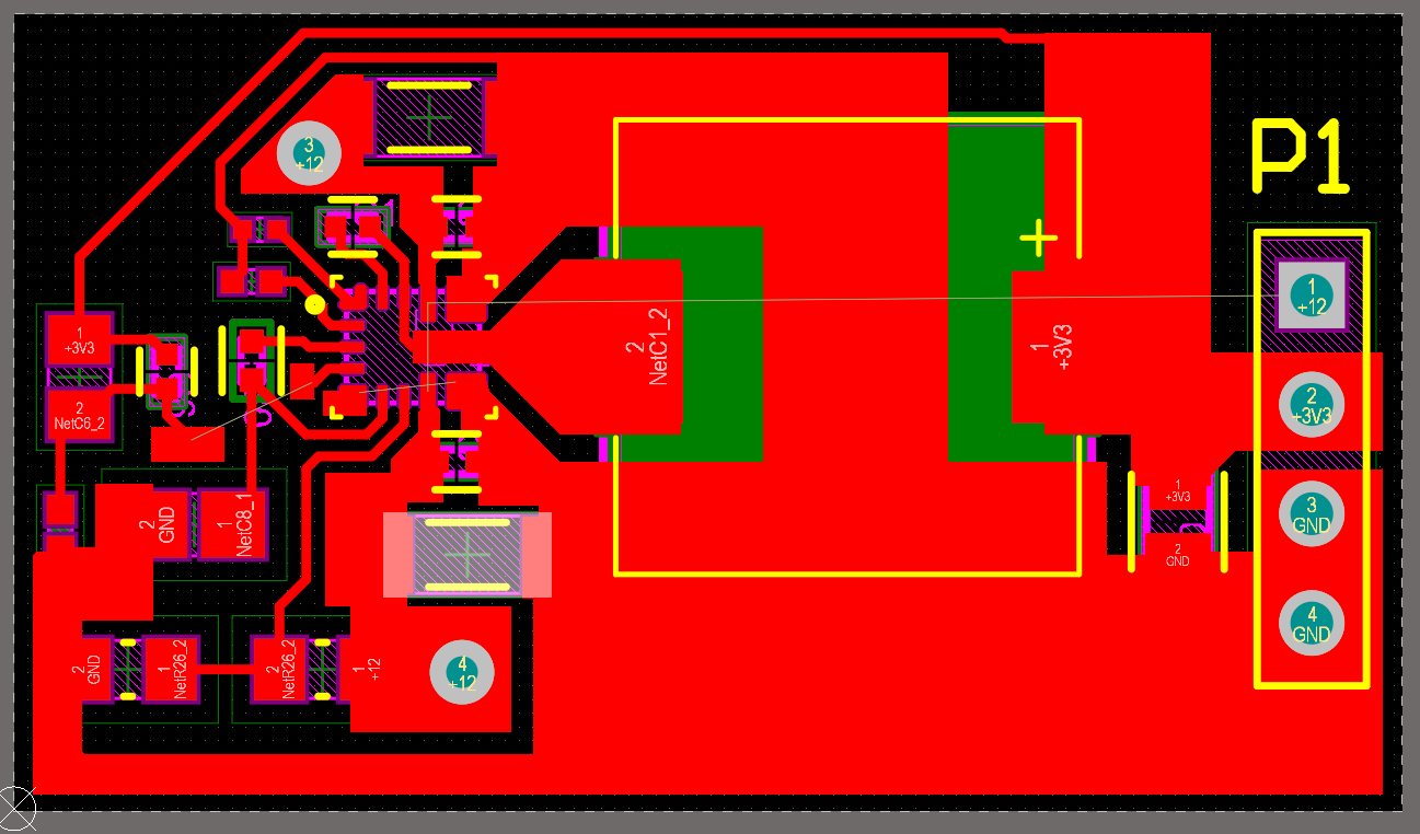

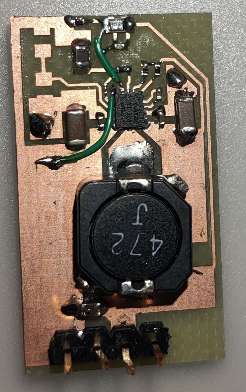

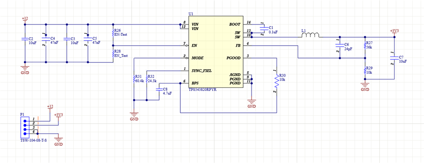

I created a power supply that generates a 3.3V voltage from 12V to drive some LEDs. These need a larger current under full load. The power supply should be able to deliver a maximum current of 4A at 3.3V. With the Webench Designer I put together a circuit with the TPS543820RPYR. I have built the circuit in a test setup. This provides the desired voltage of 3.3V at the output. The problem, however, is that I can only put a minimal load on the feed. I have built the circuit exactly as calculated by WEBBENCH. The recommended components were perpetuated. Also the layout was taken as good as possible from the datasheet.
The circuit is a light, which switches a series of LEDs on and off via MOSFETs. The LEDs are to be dimmed via PWM.
Components according to Webbench designer:
- L1: MSS1048-472NLB
- Cout: 10uF
- Rfbt: 56k
-Rfbb: 10k
- Cff: 24pF
- Cboot: 100nF
-Rpg: 10k
- Rboot: 0
- Cbp5: 4.7uF
- RFsel: 24.3k
- Rmode: 60.4k
- Cin1,2: 10uF
- Cinx1,2: 47nF
I load the circuit with power resistors. (0.88Ohm) --> 3.3V/0.88Ohm = 3.75A
However, it then tears me the voltage together and the circuit pulses on the Output.
