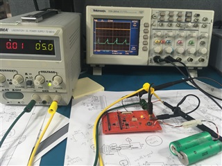

  • Hello Wyatt,
    Thanks a lot for your reply. Because find the attachment for waveforms as you requested. For Vbus, I used Bench power supply 5V and Yellow colour DC 5V waveform is VBUS and for SW pin, again 5V across 17 and 18 pins of BQ25886 chip. As you can see in the above pic, Only /PG is glowing (HIGH) while the STAT pin is still flashing at 1Hz (which states fault). Vbus=5V, SW=5V and my Battery is 7.37V
    And as you mentioned about shorting the Inductor, I bypassed a small wire across L1 (as per schematic), I could not see charging but STAT LED is off (LOW). As per the data sheet, it means either charge disabled or Fully charged (I do not think it is fully charged because I do not see any current value in Bench power supply or should I discharge battery a bit until Vbus>Vbat and test it).
    And how can I take waveform for Ibus. Sorry, could not be able to do it and also do you recommend us to buy an Evaluation board and try it once. Looking forward for your reply

  • Hello Wende,
    I meant to reduce the trace length of your PCB layout for the inductor paths, not to short the inductor. Shorting the inductor may cause damage if any of the voltages or currents exceed the absolute maximum ratings.
    I would also recommend adding more capacitance to your PMID pin to prevent inrush current issues. Is the blue waveform the SW? Can you also show a waveform during the initial VBUS plugin of a longer timeframe on the scope?
