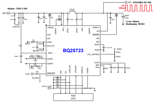

  • I drew the operating state of "SYS" on the charger
    Please check it.

  • Can I ask an additional question?
    (1) As attached image, is it possible to design only the Buck converter's FET circuit?
    (2) Other manufacturers IC(VSYS capacitors) could not compensate for the Battery voltage.
    (In case of instantaneous current consumption operation)
    Is VSYS capacitor(10uF) enough for this product(BQ25723)?
  • Hi Qiu,
    1. Unfortunately the answer is no, you need all 4 MOSFETS if you use BQ25723.
    2. 10 uF is just the label on the block diagram, we actually have more on the EVM. You will need more than 10uF. This answer to this question is complicated because it is dependent on your slew rate, load current transient amount, etc. In general, it should be fine if you reference the EVM. You can tune the circuit afterward if needed. 60 ms is not a very fast transient time. Transient only applies when the IC is regulating the voltage on the SYS rail. In battery only condition, battery will do the majority of the lifting to hold up the SYS rail.
