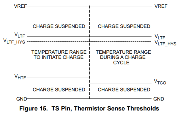

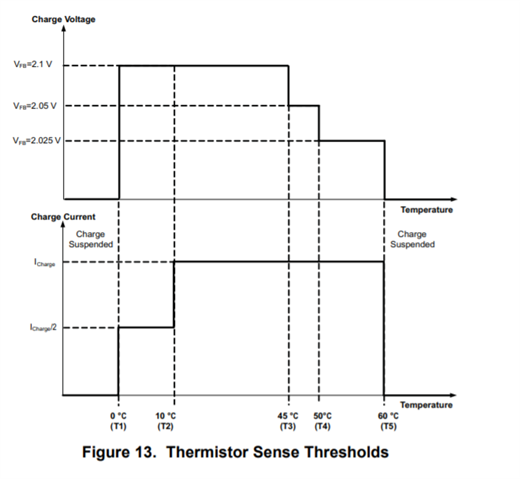

  • Dear Hardy,
    As shown in the table, they have the same cell count, charge voltage, input overvoltage, maximum battery charge current, switching frequency, and IINDPM.
    They can be interchanged, just please keep in mind the follow differences:
    1. The differences in input voltage range: 5 V to 28 V for BQ24610 and BQ24616 while 4.7 V to 28 V for BQ24618.
    2. The BQ24616 has a JEITA Charging Profile while the others do not. This means that instead of a simple window with full charge and voltage throughout the temperature window in the BQ24610 and BQ24618, the BQ24616 can reduce charge current and charge voltage depending on the temperature. Please make sure you account for these differences as this could prevent full charge or slow down the time it takes for full charge. I have attached the differences in the temperature schemes below:
    BQ24610:
    BQ24616:
