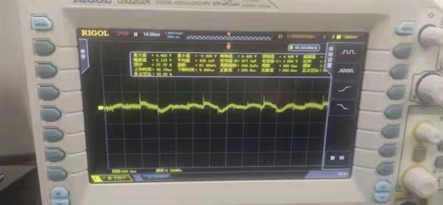

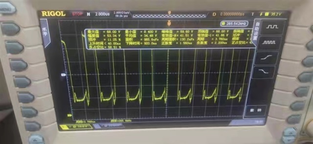

The problem is : While under light load condition, the inductor would whistle.
Following is the waveform under no-load condition:
Fig.1.waveform of mosfet                                                                                 Fig.2.waveform of output voltage ripple
What could cause this phenomenon?

    Can you please check the frequency of the load signal while in light load? It is possible that this is the root cause for the noise created by some components.
    Please check the output voltage for lower frequency oscillation as acoustic frequency is below 20 kHz.
    Please check as well if the noise is gone when you remove the inductor from the board and connect it via short wires. This decouples the inductor oscillation from the board.
    Please take measurements of both switch nodes for a longer period of time.
