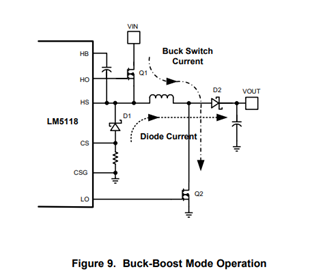

Hi team,
My customer want to use LM5118 to do a buck-boost converter, and his design is based on the pmp7851. and he want to know how to select the Schottky and MOSFET.
Here is the circuit specification:
PMP7851.1
Vin (Min) (V) 30
Vin (Max) (V) 60
Vout (Nom) (V) 54
Iout (Max) (A) 1.25
Switching Frequency 300k
Isolated/Non-Isolated Non-Isolated
Input Type DC
Here are my questions:
1.) According to the datasheet, I can find the voltage stress of Schottky and MOSFET. but I do not understand how to find the current stress, because this circuit has two mode buck and buck-boost mode.
Could you tell me how to calculate the maximum current on D1, D2, Q1, Q2?
D1 max voltage
Vin_max
D2 max voltage
Vo
Q1 max voltage
Vin_max
Q2 max voltage
Vo
2.) In this case I choose 100V Schottky and MOSFET. is this make sense?
3.) I use Tina TI to do the simulation based on the pmp7851's specification, but the result is not accurate, could you help me to check the file.
