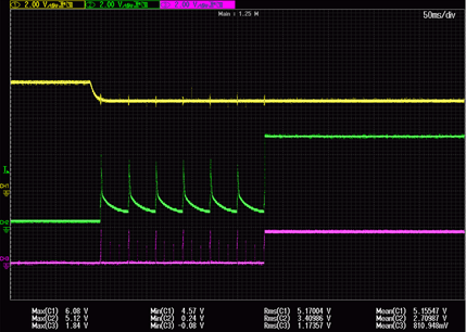

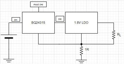

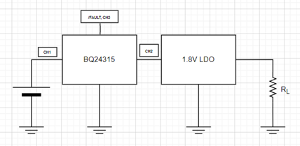

Please refer Figure 1 for simple block diagram (CH1 = power supply input (yellow), CH2 = VOUT from BQ24315 OVP/OCP IC (green), CH3 = /FAULT pin with pull up to 1.8V (red)) to illustrate circuit application.
Figure 1 – Original circuit application
In Figure 2, it presents all waveforms that I’ve captured so far. I’ve introduced an input voltage step change from 6V (OVP trigger at about 5.85V = VOVP) to 5V (expect output voltage recover immediately as usual). As you may noticed, it’s obvious that output voltage (as well as /fault pin) suffers sort of undesired oscillation and take about 180ms to stabilize. It’s out of my expectation when I compare this behavior with respect to waveform presented inside BQ24315 IC datasheet.
Figure 2 – Waveform captured with original circuit application

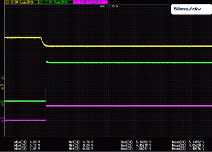

After some troubleshooting, I found out that above-mentioned abnormal behavior will be resolved when I added extra 1ohm in between BQ24315 IC GND and power supply GND (refer Figure 3 for modified block diagram and Figure 4 for waveforms captured).
Figure 3 – Modified circuit application
Figure 4 – Waveform captured with modified circuit application
However, I still can’t figure out why additional 1R will help to solve undesired oscillation during input step change from 6V to 5V and what to cause such undesired oscillation.
