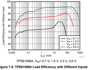

I need find the boost IC, input voltage is 1.2V~1.55V, the output voltage is 2.8~3.3V, the load is uA level,could you kindly promote a suitable part ? and need high efficiency.
Other Parts Discussed in Thread: TPS61099
Hi ,
my customer project is applied in button cell (battery), it belongs to medical consumable, so most of time the product is in sleep mode , so they have to need a boost power to BLE SoC , so need high efficiency;
because DAC 1.5V power and supply consumption is uW level is hard to find
Hi Cooper,
Thank you for letting me know. How do you think about TPS61099?
