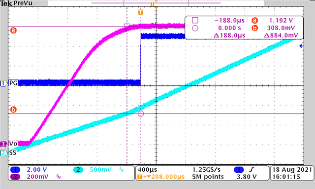

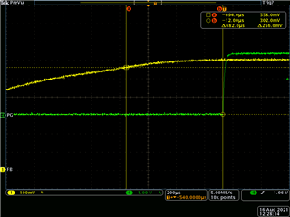

What is the PG delay(PG start-up delay ) of TPS568215?
I think it is Delay 200us after FB PIN reaches 0.558V, but the measurement result is not
1. Delay 200us after FB pin reaches 0.6V
2. Delay 200us after FB PIN reaches 0.558V?
FB pin =0.6V  100%
FB pin =0.558V 93%
CH1 FB
CH2 PG
