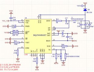

The hardware system is in the charging state, VSYS is loaded, and VBAT is also loaded. It has been charging for less than 20 hours, and it is found that the battery is under voltage protection. The customer schematic diagram is as follows
My analysis here may enter the safe timer state, and exit the charging mode after 20 hours. However, according to the manual, the voltage drops to VRECHG will enter a new charging cycle, and the Safe timer will be reset at the same time.
Please help us to look at the problem, thanks.

    If you have a external load on VSYS then the charger may be in supplement mode and drain the battery to low voltage protection.
    We would need more information of the system to debug further: SYS load, voltage and current log during this period, VBUS current and voltage.

  • Hi Wyatt,
    thank you for your reply.
    During charging, a battery with VBAT=3.7V is connected to the system and starts charging VBUS=5.1V IBUS=1.2A (constant current);
    When it is almost full, the current begins to drop (constant voltage), until Vin=100mA or so, the current does not fluctuate .During this period ISYS=200mA IBAT=300mA Load power consumption is fixed

    1.Referring to 8.3.6.1 Autonomous Charging Cycle on the d/s, When a fully charged battery is discharged below recharge threshold , the device automatically starts a new charging cycle.
    2. The safety timer is 2 hours when the battery is below VBATLOWV threshold and 10 hours when the battery is higher than VBATLOWV threshold.

  • Alon,
    The device has built-in safety timer to prevent extended charging cycle due to abnormal battery conditions.
    8.3.6.6 Charging Safety Timer on the d/s, During input voltage, current, JEITA cool or thermal regulation, the safety timer counts at half clock rate as the actual charge current is likely to be below the register setting. For example, if the charger is in input current regulation throughout the whole charging cycle, the safety timer will expire in 20 hours. In normal charging operation without input voltage, current, JEITA cool or thermal regulation, the safety timer should expire within 20 hours.
