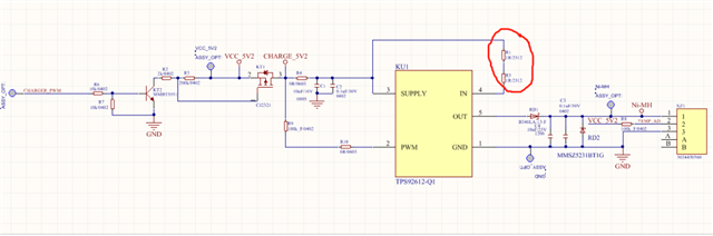

Hi Team,
What package is suitable for R1 and R5 resistors?
What's the output current?
You can simply follow the equation 1 on the datasheet
to calculate the resistor value and then the power, thus you can decide the package.
