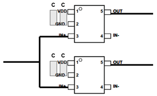

My customer wants to know should they connect output of UCC27517 together or not when driving 2 MOSFET by 2 UCC27517,
could you kindly help confirm it and let me know the reason of your answer? Thanks.

  • Hi Aaron,
    Thanks for explaining the reason. Let me double-check, so following connection is correct if customer wants to control two MOSFET by two UCC27517?
    Regarding following statement, let me double-check.
    Do you mean the trace between "UCC27517(1)'s output to MOSFET(1)'s gate pin" and "UCC27517(2)'s output to MOSFET(2)'s gate pin" should be symmetrical and equal-distance?
    To ensure the two power FETs turn on as close as possible to the same time, the input signal trace should have a symmetrical / equal-distance path to each of the input pins.

  • Hi Jo,
    Yes, this is schematic is correct.
    The customer should also locally bypass each of the drivers with at least one 1uF capacitor directly across the VDD and GND pins.
    But to be safe, they should bypass each driver with a 0.1 uF capacitor as close as possible to the VDD and GND pins and a 1 uF capacitor next to that.
    Both the IN+ traces need to have the same length, and both of the OUT traces need to have the same length as well.
    Also, the customer will want to make sure the driver is very close the the power FETs as well to minimize the current loop to the gate of the FETs.   Consider looking at the "Layout" section of the datasheet.
