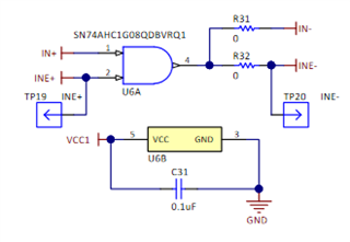

    Since the UCC21750 is a single channel driver the dead time with the other gate driver in a half bridge configuration is handled external to the device. This can be done through the software controlling the PWM signals into the drivers.
    For additional protection you can also implement additional logic components to prevent shoot through events. An example of this can be found in the UCC217xx evm User Guide. This EVM uses a CMOS logic AND gate (SN74AHC1G08QDBVRQ1) to prevent from having overlap between between the high and and low side PWM signals. In this example when both IN+ input signals for low side and high side turn ON the AND gate will make the IN- inputs high as well to disable the drivers.
