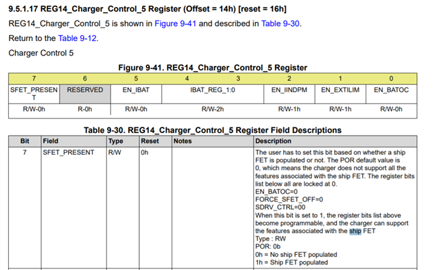

    I have both the USB-PD-CHG-EVM-01 and the BQ25792EVM.
    I am using the USB-PD-CHG-EVM-01 to develop the comms with my MCU and the BQ25792EVM to test ship mode.
    I am having some issues putting the BQ25792EVM into ship mode.
    It is set up with the shunt and switch suggestions from the user guide, with a few changes.
    I have a 2s battery pack connected to BATTERY and PGND on J5.
    A PSU is connected to J6.
    JP1 is connected to GND and JP3 is installed to bypass the MOSFET.
    JP5 is not installed and pins 2-3 are shorted on JP8.
    Apart from these, all the shunts are as 'BQ25792EVM, BQ25796EVM, and BQ25798EVM (BMS034) Evaluation Module' suggests.
    I can communicate with the BQ25792 from my MCU.
    When i read the 'REG11_Charger_Control_2 Register' i get '0x40'
    I then write '0x45' to the reg. This should put the BQ into ship mode with no delay (setting SDRV_CTRL_1:0 = 2 & SDRV_DLY = 1).
    Once this has been written to the register, i read it again.
    It results in a value of '0x41'.
    It seems to be ignoring the ship mode bits, is there anything that i have missed?
    Kind regards
    You need to enable the Ship FET first.
    Please see REG14 for the SFET_PRESENT bit which needs to be set before trying to control the Ship FET.
