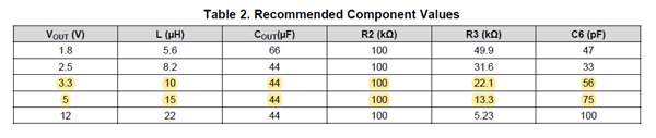

The customer would like to use TPS54302 to replace TPS54202. Whether the two device can replace to each other? Which component need to be change?
Because the different switching frequency of two device, the value of inductor is different.
1. For Vo=3.3V, whether customer can use 10uH of inductor on TPS54302?
1. For Vo=5V, whether customer can use 15uH of inductor on TPS54302?

    Yes, they can replace each other. Something to highlight:

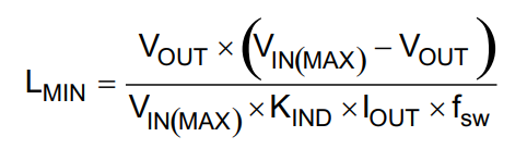

    1. Use equation shown below to calculate the minimum value of the output inductor (LMIN):
    KIND is a coefficient that represents the amount of inductor ripple current relative to the maximum output current.
    Switching frequency of TPS54302 is 400kHz while switching frequency of TPS54202 is 500kHz.
    Vin(max), Vout, Iout is the same for TPS54302 and TPS54202, while fsw is different.
    If you want to follow the same KIND as before, you need to use 12.5uH(Vout=3.3V), 18.75uH(Vout=5V).
    However, the customer can still use 10uH and 15uH for Vout=3.3V and 5V, while it will effect the value of KIND which would be increased.
    2.For designs using low-ESR output capacitors, such as ceramics, a higher KIND can be used. When using higher ESR output capacitors, KIND = 0.2 yields better results. a reasonable value of KIND should be 20% to 60%,
