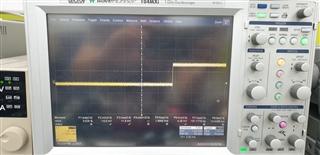

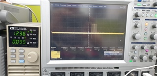

Note: As shown in the attached screenshot, GPIO3 (EN_MCU3V3_LDSW) moves for about 1 second and then falls to LOW.
TPS65941212RWERQ1 RSTOUT Pin (GPIO11) waveform.

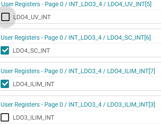

  • Hi S.H,
     1) From register value, it shows LDO4 has an issue. Please try to reduce the cap on LDO4 output; higher cap value may cause LDO ramp up too slow to cause the interrupts below.

  • Hi, Phil.
    Thank you for feedback.
    I removed some capacitors related LDO4, issue is cleared !
    And two more questions.

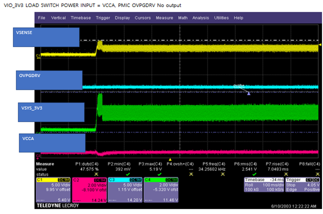

    And I found another issue related VSYS_SENSE.
    When powering on the unit, frequently PMIC VSYS_SENSE failure observed as below screenshot. (Sometimes automatically recovered, but sometimes hanged.)
    And I try to change the power source of load switch for VDD_IO_3V3, VCCA to VSYS_3V3,  issue is disappeared. (even if Vsense peak voltage is higher.)

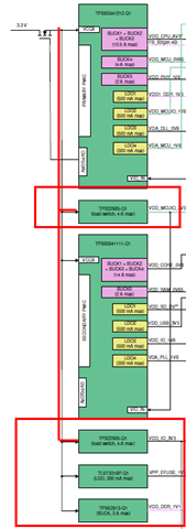

    In application note (slvuc32) 5page block diagram, load switches are connected VCCA source.
    Q2> Could please advise the correct power source connection for VDD_IO_3V3 load switch?
    Q3> If the power source connection is correct (VCCA), what can be impact VSYS_SENSE ?

  • Hi S.H,
    A1: Please see datasheet screenshot below:
    A2: VCCA.
    A3: VSYS_SENSE failure is caused by the VSYS_3V3; Overshot on VSYS_3V3 should be fixed.
