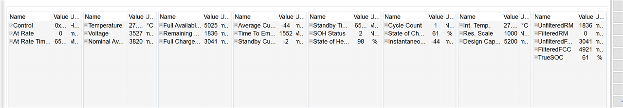

I have performed what I thought was a successful learning cycle on my 1S2P 18650 battery pack but the fuel gauge provides inconsistent results especially when seeing higher loads. A few things I have observed:
1. Starting from a fully charged battery, the fuel gauge shows what appears to be a normal discharge curve until it hits about ~50%. Then it drops right to 0%. Battery voltage is still around 3.7V OCV.
2. Another example. When charging the battery the capacity is reported to be 30%. If I stop charging the capacity will drop to 0%.
3. Reported Capacity looks normal when charging.
I have attached my logs from my learning cycle for review. Appreciate any help
Eric

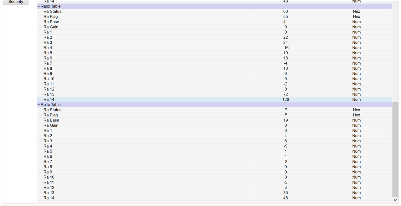

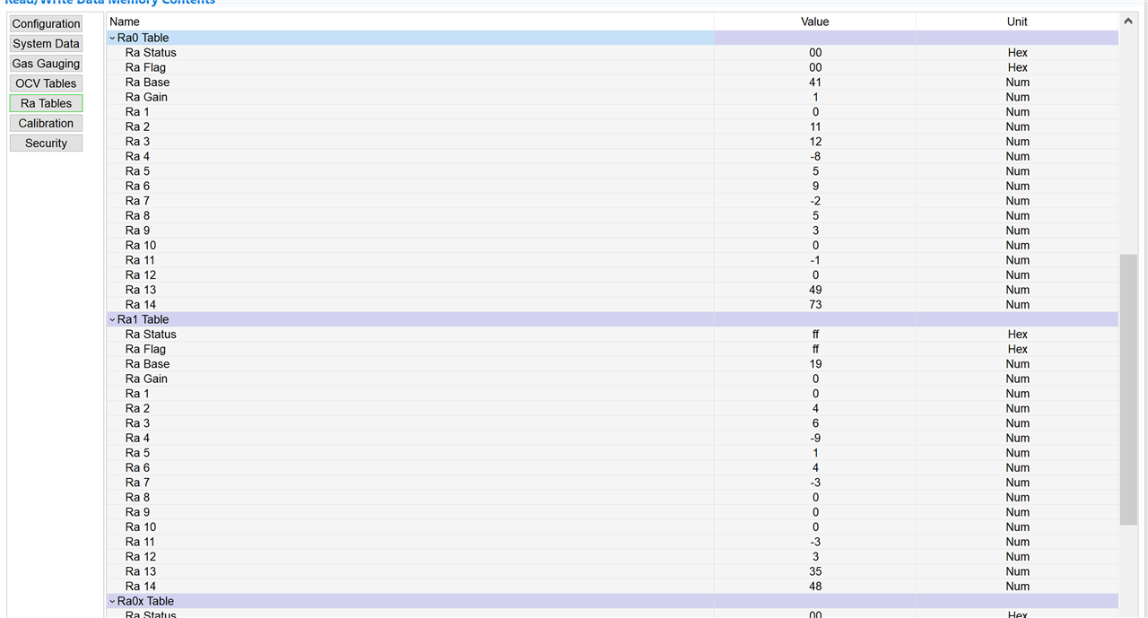

    I redid the learning cycle. It completed successfully although I still had a couple of Ra values that ended up being negative.  The discharge seems to work well but then suddenly drops to zero. I have to run an OCV Command to reset back to the accurate capacity. I'm assuming this has something to do with the RA values being negative?
  • The Ra values are not stored as absolute mOhm numbers. Instead, this gauge uses a differential format with a base and gain and delta values. A negative entry just means that the Ra for this entry is less than the preceding entry.
    If the gauge calculates a negative Ra, it will not store this in the Ra table (because it's invalid). Instead it will set RUP_DIS (=Resistance UPdates_DISabled) and disable Ra updates.

  • To clarify:
    Negative entries *in the Ra table* are ok, because the table stores the difference between grid point values.
    So if the absolute resistance of Ra[X+1] is < Ra[X], then the relative entry stored in the table for Ra[X+1] will be negative. But that doesn't mean that the resulting cell resistance is negative (for example, if the gain value is 0, then this translates to an effective gain of 2^0 = 1. If base is 100 then the absolute value of Ra0 is 100mOhm. If the entry for Ra1 is -10, then the absolute value of Ra1 is 90mOhm, not -10mOhm).
    If the gauge calculates a negative cell resistance, then in this example, the entry for Ra1 would be <-100. If Ra1 would be -1mOhm, then the entry for Ra1 would be -101.
    However, the gauge will never store a resistance value entry that would result in a negative absolute resistance. It will simply set the RUP_DIS bit and disable all resistance updates during the discharge when this happened.

  • Hi Dominik, thanks for your thorough response. I suspect it is possible that the cause is the temperature change as I see it steadily rising throughout the run as the battery voltage drops and current rises. Our battery pack also has a thermistor that is not the identical required coefficient (3435k). I was able to capture logs while doing a discharge at our max rate. Could you please have a look and see if you can determine what is causing the jumping around. 6825.Logs.zip

    Your log files show that the gauge estimates very little capacity at the first discharge simulation after start of discharge. The gauge's initial estimate for FCC (and RM) is based on the Avg P last Run, which is 3W. The actual discharge power is about 10W so the first grid point simulation will predict capacity for a 10W load instead of 3W.
    The issue is that your cell resistance is fairly large until grid point 4, where it diminishes significantly. What likely happens is that before grid point 4, the capacity simulation causes the simulated voltage to drop below terminate voltage prematurely, resulting in small FCC and RM. Once DOD crosses grid point 4, cell resistance is much less and FCC and RM recover.
    --> Set Avg P Last Run to 10000 and set Ra Base to 10 and Ra4 to 0.
    The manual Ra adjustments are not ideal but they will confirm, if the analysis is correct. If it is, the initial learning cycle wasn't done correctly.
