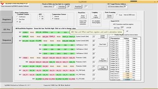

1. Why did cell 10 and cell 15 of BQ769X0 read data on the evaluation software that was 5mV lower than the actually measured voltage, and others cell voltage are normal?

    1. In your specific case I don't know.  Possibilities may include part to part variation, or use of Schottky diodes between the top group input and power pin as shown in figure 14 of the data sheet https://www.ti.com/document-viewer/BQ76940/datasheet/typical-applications-slusbk29872#slusbk29872 instead of conventional diodes.  With a shorted thermistor  the added load on the supply pins in addition to the ICC_BAT or dINOM current may forward bias a Schottky diode.  Check for unexpected voltage drop across the resistors for VC5, VC10 and VC15.  Note that the top input of the group does have higher current than the other inputs, but the dICELL max of 0.5 uA should give 0.5 mV across the typical 1k filter resistor, not the 5 mV reported.
