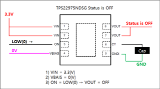

Currently using TPS22975(NDSG) Part, I have a question regarding operation.
Is there a risk of damage to TPS22975(NDSG) under the following conditions?
(This is a situation where 3.3[V] is applied to Pin VIN when TPS22975 is OFF.)
 1) VIN=3.3[V]
 2) VBAIS=0[V]
 3) ON=LOW(0) → VOUT=OFF

  • Hello Jaehak,
    The device would not be damaged from it; however, that is not within the recommended operating conditions and it's possible to see unexpected behavior.

    Since I'm concerned about the "unexpected behavior" you mentioned, I have an additional question.
    under the conditions below
    If voltage (or leakage voltage) is output from Pin Vout and Pin VBIAS, it becomes a problem.
     1) VIN=3.3[V]
     2) VBAIS=0[V]
    Is it correct that Pin Vout and Pin VBIAS do not have voltage outputs?
    If there is leakage voltage, please tell us the percentage of leakage voltage based on 3.3[V].

    By "unexpected behavior" I mean the device is not specified within those operating conditions and therefore could exhibit characteristics not defined. We can not make any guarantees outside of the datasheet. I would suggest following the recommended operating conditions
