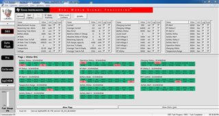

    The steps are valid only if device is in full access mode. Can you post a screenshot of bqEVSW FAS and SS bits?
  • Hi Shirish
    Herewith attached the screen shot of BQSW Window of FAS and SS bits.
    We have tried to write the commands and try to give the write command, But the value does not changed.
    Kindly help me to write the files on the concerned value areas and to perform learning cycle.
  • Thanks. It is in FAS mode, so you should be able to write data flash values. Which parameter are you trying to change?
