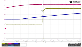

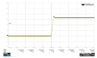

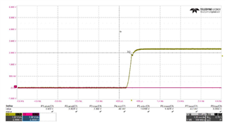

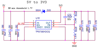

TPS73801DCQ here C72=10nF.
Then the 3.3V curve shows like below,there is a overshoot (3.6V maxium)
If i change the value of C72, when C72=100nF, overshoot will reach 4V maxium  (3.3Vtyp).
I change the value of C72,  when C72=33nF, overshoot will become to a ditch .
So i am confused about how this happen. Maybe the power on load of TPS73801DCQ is too large?
I change the value of the output capictor c75,but there is no significant use.

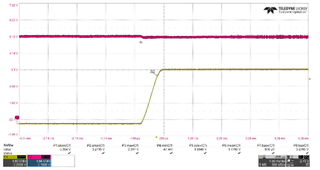

So i change the ic to TPS73701, then there is a good startup curve.

              If the ramp rate of VIN voltage source can be controlled, then slowing the ramp rate would give the LDO control loop more time to respond and the VOUT startup ramp would be more smooth. Increasing the input capacitor (C80, C81) would help in a similar way and make the VOUT ramp smooth. TPS73801MDCQPSEP and TPS73801DCQ would be very similar to each other in performance of Electrical characteristics. The SEP version has packaging suitable even for applications in Space and can withstand very high radiation levels. Thanks!

  • Purple curve is NET_5V, Yellow curve is NET_3v3.
    NET_5V has 200uF capacitor, i think it is enough . But the overshoot exists.
             200uF is a substantial cap. Could you provide us the input current scope shot along with the VIN and VOUT? Could you also increase the cap on the enable pin or slow down the ramp rate of the enable pin voltage and verify the overshoot? Thanks!

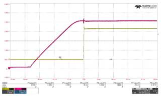

    This LDO circuit is used in real assembly pcb,then i measure the curve
    purple curve:5V; yellow curve:3v3;blue:en     en is about 0.5V, then 3V3 begins
    Then i delete output capcitor C75=22UF, but i cannot delete all the capacitor on this assembly pcb.
    The curve (C75=NP) is same as the original curve (C75=22UF).
    In fact,  i have increased C75 value, then the ditch will become to step.
    I will change TPS73801 to TPS73701 to solve this problem.
