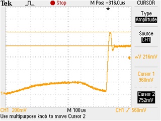

Hi Sir/Madam,
We are testing TPS51200 with our design.
We observed overshoot on VO and VREFOUT with values of around 200mV during power on cycle.
What could be the reason for this overshoot?  Can you help to share such reading from the evaluation board?
  • VO_Overshoot
    REFOUT_OVERSHOOT

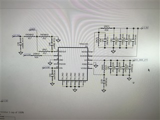

  • Kalpesh,
    What capacitance do you have on the REFOUT pin? Do you have a schematic that I can view? People have seen this issue in the past by not using the recommend capacitance on the REFOUT pin.

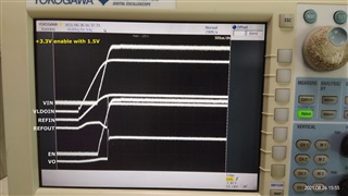

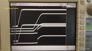

  • Hi Kadeem,
    We have tried with delay on 1.5V and make the 3.3V earlier just to validate the behavior. (However, We may not able to do this as we have used AM3352 in this project which need 1.5V first and then 3.3V).
    Refer the images, Overshoot removed and glitch lower down.
    We have validated REFIN pin and no any overshoot observed on it. Refer two more image with white color waveform. (3.3V direct means, 3.3V before to 1.5V). (3.3V enable with 1.5 means, 3.3V after 1.5V).
    What could be the maximum capacitor value can be used on REFOUT? Increasing REFOUT capacitor is helping to reduce overshoot.
    With 10uF on VREFOUT, Overshoot reduced to 32mV from 216mV.
  • Power On with 3.3V later to 1.5V
    Image-1 : 3.3V after 1.5V
    Power On with 3.3V before to 1.5V
    Image-2 : 3.3V before 1.5V

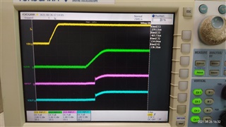

    No overshoot on VIN and REFIN (3.3V after 1.5V)
    Image-3 : No overshoot on VIN and REFIN(3.3V after 1.5V)

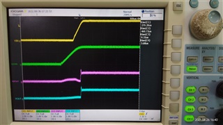

    No overshoot on VIN and REFIN(3.3V before 1.5V)
    Image-4 : No overshoot on VIN and REFIN(3.3V before 1.5V)
