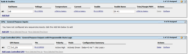

    2. In the Rail Configuration, what the GPIs On dependecies and GPIs Off Dependencies mean? For example(refer the below screenshot), what is the relationship between the rail and the GPI (RAIL UP). Will the rail be powered up when the RAIL_UP(GPI)  is high if I select the RAIL UP in the GPIs On Dependencies? Or, Will the rail be powered off when the RAIL_UP is off if i select RAIL_Up in the GPIs off Dependencies?
    One more question:
    3. The 3v3_EN will be high when the 1v8 rail is ready, then the 3v3 rail will be powered on(like below screenshot). However, i find the 3v3 rail is still on when 1v8 rail shut down, even i set turn off 3v3 if 1v8 shuts down. How do i set 3v3 rail on and off depending on 1v8? The 3v3 will powered on when 1v8 is ready and the 3v3 will be off when 1v8 shuts down.

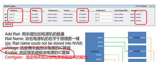

  • Is it a GPI that i configre like below picture?
  • Are the PMBUS_CTRL GPIs or enable pins that i set?
  • Which pin is control pin of power rail? Is control pin the rail enable pin or GPIs? For example(refer below picture), GPIO1 is 1v8 rail control pin, right? and  GPIO2 is 3v3 rail control pin, right? Would you please help to give a example?

  • Thanks Yihe feedback. I see the control pin usage.
    Another question: Do these enable pins enable next power rail or enable itself? Fusion Digital Power Designer document indicate the enable GPIOs to enable downstream power supply. My understanding the GPIO enable next power rail. Like below picture, the Pin4 GPIO1 Rail #2 eanbled signal, is it right?
  • Hi
    The ENABLE is designed to enable itself so that we can control it via the monitoring its own voltage.  GPIO1 is to enable rail#1.
    Yihe

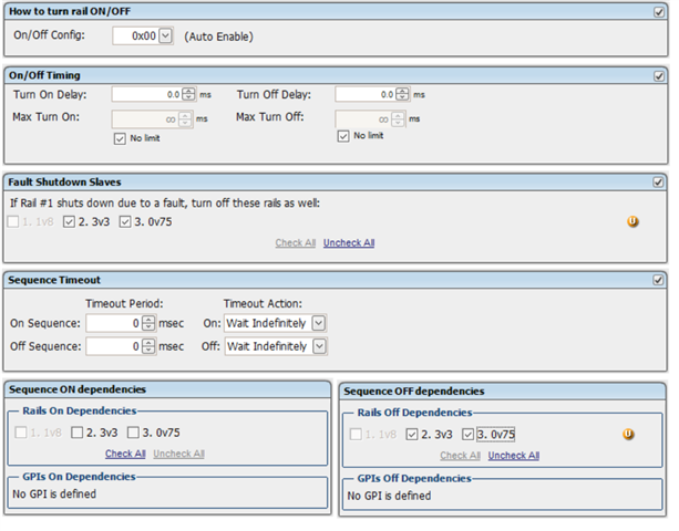

    Last question: How to set that turn off slave rails if the rail shut down? Below is what i do.
    1. Set Rail#1 Fault Shutdown Slaves Rail#2, Rail#3 as below screenshot.
    2. Set Rail#1 Fault Response Shut down immediately.
    3. Disconnect Rail#1 enable output GPIO1 or deassert Rail#1 enable output GPIO1.
    4. The Rail#1 shut down but Rail#2 and Rail#3 are still on.
  • Hi
    Do you see the orange "U"? Have you clicked the "write to hardware" button to let the changes accepted by devices?
    one more thing to check: does rail2 and rail3 have any turn off dependencies? if they do, make sure that the dependencies are met so that rail 2/3 can be off.
    Yihe
  • Yes, i confirmed i wrote to hardware. The screenshot is only an example. The below are what i do.
    1. If 1v8 rail voltage is set lower than 1.5v(triger under voltage fault), the 1v8 rail shut down and 3v3 and 0v75 rails turn off too.
    2. However, If 1v8 rail eanble signal is disconnected or is deasserted, the 3v3 and 0v75 rails are still on even 1v8 voltage is 0.
    How do i deal with the case2?

  • Hi
    Yes, the case2 setting is same as case1 setting. Do you mean case 2 won't report UV fault? The slave rials(rail2 and rail3) won't be turned off if rail1 enable signal is pulled down or Rail1 broken due to some errors, right?
  • Hi
    No, what I mean is whether the device report UV fault on the 2nd case. if not, rail2 and 3 would not be off.
    As said in the previous reply. UV fault is reported only if both conditions are met:
    1. the rail is ON(on/off_Config is met to turn on, any turn on dependencies are met to on)
    2. the rail is below it is UV threshold after reaching its POWER_GODO threshold
    how do you pull down the EN signal.
    Yihe
  • Hi
    I added the switch on the EN signal, so i can control the EN. I turn off the EN after all power rails are ready. Then, only Rail #1 shut down, Rail #2 and Rail #3 are still on. Is that normal?
    By the way, what do you mean "if not, rail2 and 3 would be off."? Do you mean rail2 and 3 would be off if UV fault report?
