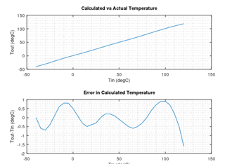

  • Hi Alex,
    Here are the best coefficients for this thermistor for the -55 to 155 range. It is difficult to get great accuracy over the whole range.
    A1-A5: -8192 -4096 20479 12287 4095
    B1-B5: -24025 23828 -8742 4503
    ADC0 = RC0 = 11703
    As shown below, it does have up to 5C error over the range.
    I also tried a smaller range to see if I could improve the accuracy. This gets much better accuracy over a -40 - 120C range, but it would get worse accuracy at extremes of -55C and 150C.
    A1-A5: -21846 27306 -10923 32767 5461
    B1-B5:   -31395   23656   -8209    4298
    ADC0 = RC0 = 11703
    Matt

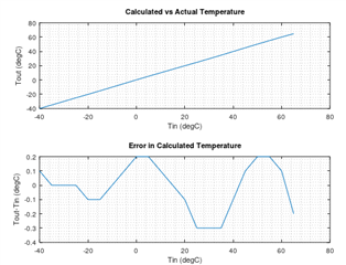

  • Also, we just verified that the -40 to 120C fit still performs poorly at low temps. At 4C the protection IC returns an estimated value of 16.8C.
  • Hi Alex,
    Here are the coefficients for -40 to 65:
    A1-A5: -10923  -10923   -5462   32767   10922
    B1-B4: -2515   5020  -4224   3808
    For your testing, I assume you are using the 18k setting and the 18k temp model?
    Matt

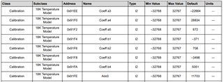

    Here is the block that configures the coefficients and the ADC0 for the 18k model, as well as the config register for TS1
    //Custom Temperature Model Coefficients
        data.length = 2;
        data.value.int16Val = -10923;
        BQ76942_Data_Memory(&hspi1, C18K_TEMP_COEFF_A1, &data, &error);
        BQ76942_Data_Memory(&hspi1, C18K_TEMP_COEFF_A2, &data, &error);
        data.value.int16Val = -5462;
        BQ76942_Data_Memory(&hspi1, C18K_TEMP_COEFF_A3, &data, &error);
        data.value.int16Val = 32767;
        BQ76942_Data_Memory(&hspi1, C18K_TEMP_COEFF_A4, &data, &error);
        data.value.int16Val = 10922;
        BQ76942_Data_Memory(&hspi1, C18K_TEMP_COEFF_A5, &data, &error);
        data.value.int16Val = -2515;
        BQ76942_Data_Memory(&hspi1, C18K_TEMP_COEFF_B1, &data, &error);
        data.value.int16Val = 5020;
        BQ76942_Data_Memory(&hspi1, C18K_TEMP_COEFF_B2, &data, &error);
        data.value.int16Val = -4224;
        BQ76942_Data_Memory(&hspi1, C18K_TEMP_COEFF_B3, &data, &error);
        data.value.int16Val = 3808;
        BQ76942_Data_Memory(&hspi1, C18K_TEMP_COEFF_B4, &data, &error);
        data.value.int16Val = 11703;
        BQ76942_Data_Memory(&hspi1, C18K_TEMP_ADC0, &data, &error);
        // Thermistor Configs
        data.length = 1;
        data.value.uint8Val = 0b00001011; // Enable thermistor input, use 18k model
        BQ76942_Data_Memory(&hspi1, TS1_CONFIG_ADDR, &data, &error);
        BQ76942_Data_Memory(&hspi1, TS3_CONFIG_ADDR, &data, &error);
