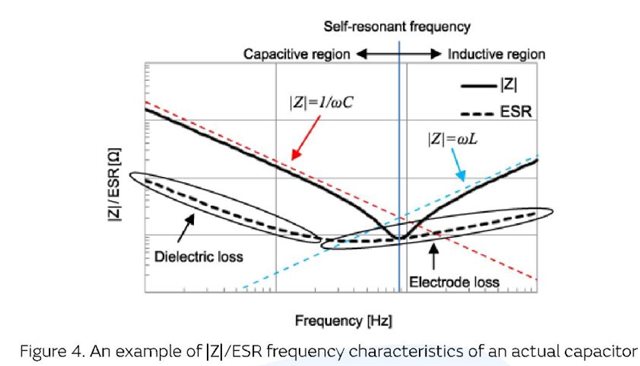

    Low ESR depends on the frequency.  See below:
    Based on the figure above, you will want to design your application such that you are at the minimum point of the ESR curve.  The ESR curve is generated by modeling a ceramic capacitor that includes the parasitic inductance and resistor.  The lowest point of the curve is called the resonant point where the impedance of the capacitor and the parasitic inductance have reached a minimum, which is roughly the equivalent to the resistor in the model (ESR).  It is my opinion that "low ESR" means anything less than 100mohms.
    Ben

    It is difficult to just give you a number because adding more capacitance on the output increases the instability of the REF3033.  The best thing to do is to keep adding capacitance until the output gets unstable then add some resistance in series with the output capacitor.  Adding the resistor will increase the stability of the design.
    Ben
