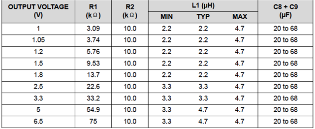

We need good voltage ripple. Can we connect a 470uf or larger capacitor at the output?
the output capacitor is related with output voltage. you can get the recommend value from table shows below. the output capacitor is C8+C9.
the table is from datasheet.
if you want to know more about how to depress the output voltage ripple, you can refer to the below link.
